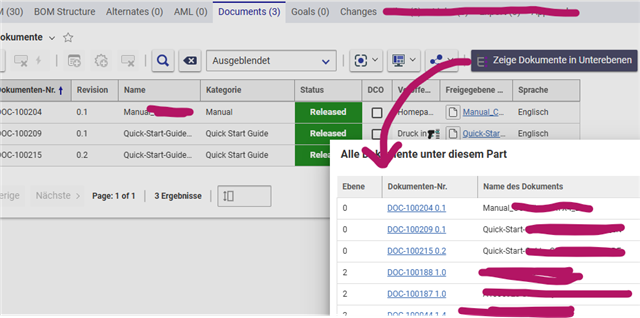

    The original idea was that I reuse my custom "all-purpose-all-in-one view". It´s a single Method that renders the result of an AML query to a simple table in a pop-up window. See following example. It uses a AML query to collect all documents hidden in the multiple BOM levels:
    That´s why I asked for the plain AML query - cause I wanted to use the same building technique to "save time" (worked well so farSmile).

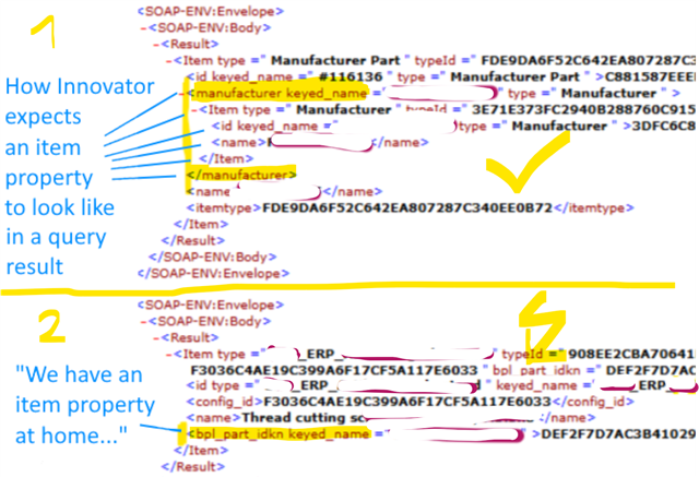

    Now I learned that my federated data isn't perfect enough for AML queries. My "crafted" item properties mainly consist of id and keyed_name. With id and keyed_name they work as clickable links in grid and Forms, but they doesn't work in QDs.
    I think we can tell the reason when we look a the data structure of similar ItemTypes (like Manufacturer Part with the Manufacturer item property). Typically item properties use a bit more data:
    I am right now a bit unsure of what to do.

    And I think I know the reason. QDs work different than the Grid. Right know my federation onGet query is optimized for the classic "Grid - Relationship - Form" trinity. But QDs work different, as they support more additional functionality like levels and reverse properties. My Federated ItemType cannot work, cause it doesn't provide the data that a QD needs. I right now just return the regular item structure but QDs works a lot with references.
