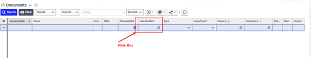

As the tilte says. We want the "Classification" property of ItemType "Document" to be hidden for a user if they are part of a specific identity.
I also want the value of "Classification" to set as "General" for these users when they search of Documents. I have achieved this. However, now we do not want the users of this identity to be able to see the "Classification" column in the search grid. How do I accomplish this.
