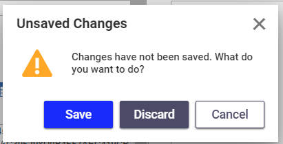

Hello,
When I open an item of the Custom item type from the search grid and attempt to close it without editing the item, Aras displays an unsaved changes warning.

    Hello
    Thanks for your quick reply. Instead of applyItemWithFilesCheck API now I'm using top.aras.saveItemEx API in javascript & now it is working fine. But for saveItemEx  API again I need to call UnlockItem API. is there any alternate for saveItemEx to avoid to call UnlockItem api?

  • Don´t use top.aras.saveItemEx but aras.saveItemEx! As mentioned before, don´t use the top references anymore if you don´t use Innovator 10. Aras it self try to remove them whenever possible.
    But I think in your case saveItemEx is maybe not the best solution. I typically use this one, when the item is already in edit mode. It´s a perfect function to edit something, while the user is editing anyway.
    If you want to use it for some kind of "background" edit action, you will need to unlock manually.
    Have you checked the linked filepicker post? Ignore the title of the thread. But the whole post contains a couple of variants for file upload for Innovator 11/12 and 14. Scroll down and look at the sample code from Gopi and Chris.
